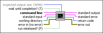

Query 2 -
You can use the System Exec VI to run an external .exe file:
Executes a system command. Use the System Exec VI to execute or launch other Windows–based applications or Linux command-line applications from within VIs. With the System Exec VI, you execute a system-level command line that can include any parameters supported by the application you want to launch.
