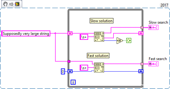

I don't think String subset is that bad, you should be fine, but you can always create a performance test to compare a couple of solutions if you're wondering. 🙂
I remember a similar problem to yours, but i think i was using Match pattern or something, and the difference in speed was surprising!
/Y

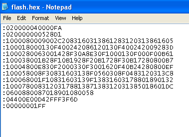

I have attached the hex file sample.
File I am dealing with has some 60K lines.
And I had to do parsing of this 60k hex file into 1D array of two digit in each element. So I first made an 1D array of each line then I processed each line into again 1D array of two digits (Note: it has an specific order to arrange these 2 digit 1D array depending on the offset address of the string line which is why i had to use string subset so many times), then I created 2D array then again i converted this 2D array in to 1D array using resize array function where I ended up with some empty elements in this final array(Empty elements are due to unequal size of each line)  That's how I needed to clear empty elements.
Hope I was able to give you a clear idea of why i did what i did.
2359509_orig2359509_orig
No, this is just an image of a hex file that is useless for us. Please attach the actual file (you can put in inside a zip file, together with the VI you are using to read it!).
We cannot debug images, for example we cannot see unprintable characters and delimiters. We can't see 60k characters and we also don't know how the fields are defined. Which part of the file shown would result in an empty array element?

@altenbach wrote:
Not to mention that I really don't feel like recreating all that text.
