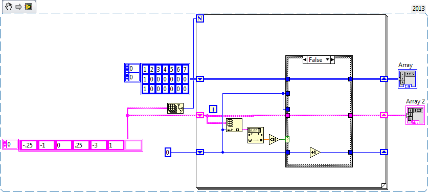

I have a 1D array of data which varies betwen positive and negative values. I am trying to search it for negative values and remove them from the array.  This corresponds to column data in the second 2D array which also needs to be removed. One minor issue is that there is one extra column in the 2D array which has to be skipped over.  I have code which should do this.  The problem is that if I have two negative numbers in a row the code doesn't thow out the second one.
This first picutre is the answer I get when positive and negative values alternate.  It is displaying the correct answer.

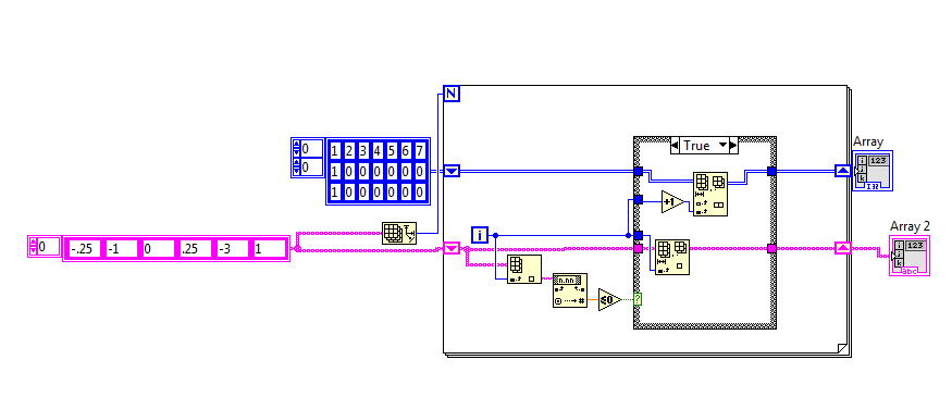

When I change the first1 from positive to a -1 as shown below...

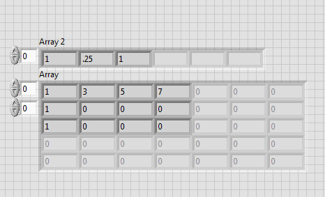

... I get the following answer.

Your problem is that you are using the "i" in the loop.  "i" is not in sync with your array when deleting something in it.
(7,371 Views)
Accepted by topic author Cseaman
Here's the solution, only increase the index when you don't delete an element. In addition you were using the "less then or equal" when you should use the "less than".
(7,359 Views)
Also, you are taking i+1 for your 2D array, but only i for your 1-D array.  So you are not even working on the same index of the array like you thing you are.
I see you have LabVIEW 2011.  I don't think that version had conditional tunnels yet.  If it does, then that is the easiest way to code this.
If not, you will need to maintain your own count within a shift register instead of using i.  If you need to delete something, then just past the i through, (because everything later in the array will move up).  If you don't, then add 1 to the counter and put that back into the shift register.

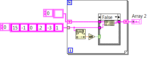

I like using the build array function, when I am trying to eliminate an element from a current array. Something like this (I only used the string example)

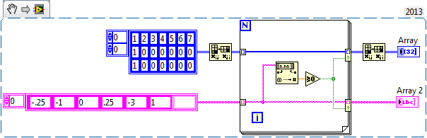

Use auto indexing on the input and conditional indexing on the output.
Can't get much simplier.
