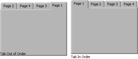

Guenters solution will work if you can programatically determine your tab order.  If you would rather rearange your tabs though (see example)tabs.PNG
I haven't found a way to set this programatically-
