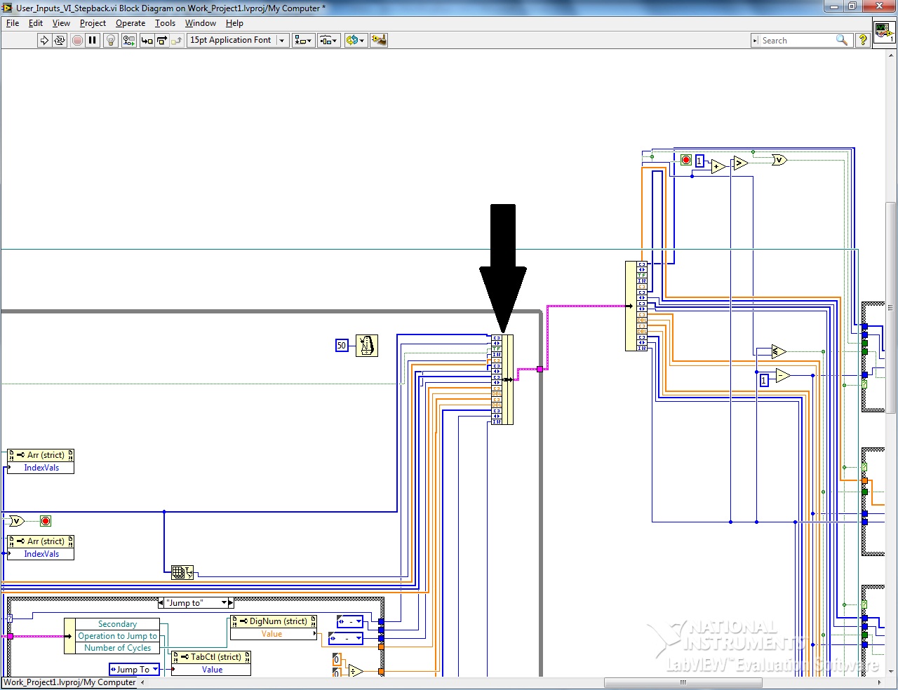

Ok so I have this code and here is what I want to do. I used the bundle function to organize sections of the code and flow information into a sub VI (I removed the sub VI for the purpose of this post). now I want to replace that bundle block with a bundle by name block to make it easier to udate the code later if I need to. So I want to replace this bundle

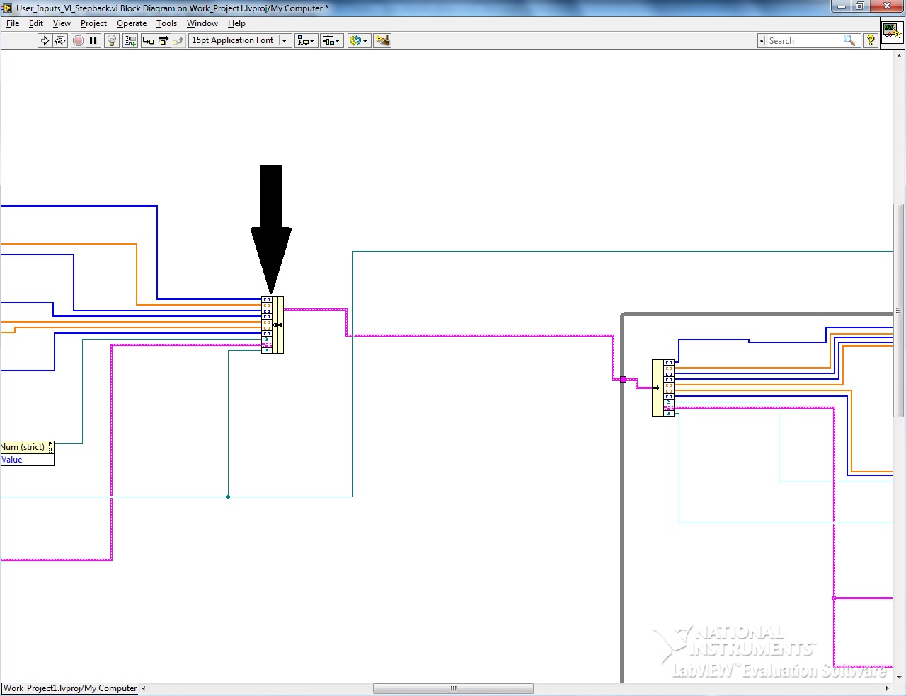

and this bundle

The thing with bundle by name is that it needs a cluster to be passed into it as a type def.  So what I did was right-click on the cluster wire, create constant.  Name all of the elements.  It's big, so view as icon.  Wire the new cluster into the input cluster of the bundle.  Right-click on the bundle and replace with Bundle by Name.  And all was good.
(6,018 Views)
Thanks crossrulz I was trying for forever to figure that out. Really obvious now that I think about it haha. Appreciate your time.

You really do not have names for the Bundle by Name.  When you put the wiring tool over the array the context help shows: 1D array of Select Option 2... The array itself does not have a name even though it consists of named typedefed elements.
I suggest that you have bigger problems than naming your cluster elements. The use of Value property nodes and control references to move data around is about the worst way you can do it in LabVIEW.  Wires are always the best way when they can be used. In your code it looks as though everything could be wired directly.  That would drastically simplify your diagram by itself.  Also using Build Array inside a loop results in frequent memory reallocations and can slow down your program or even make it crash. Pre-allocating an array and using Replace Array Subset is the preferred method of putting data into an array.
I suspect that if you used wires wherever possible, the size of your BD would be 1/4 what it is now.

The primary reason I used the property nodes and control refrences is becasue I plan to put the inner loop into a sub VI and then the outer loop as another sub VI and then the entire thing will be part of a larger code. It was my understanding, and I could be wrong, that I needed my controls outside of the sub VI for them to work on the front panel of the main VI, hence the refrence/property node stuff.
I had been looking for a way to replace the build array comand, so I may look into using Replace Array Subset.
