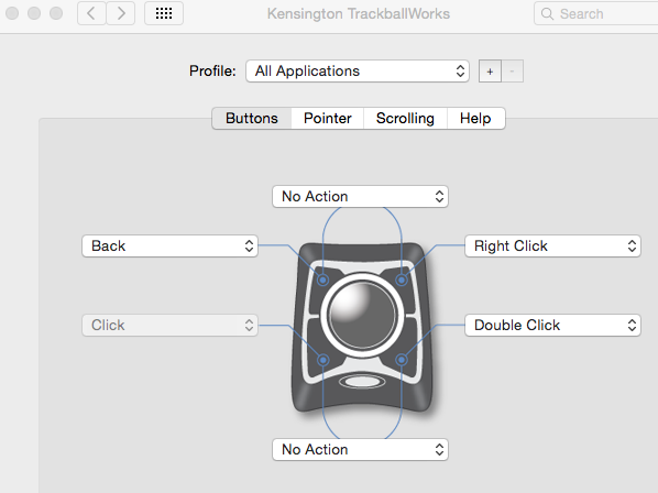

If you use a third party mouse with multiple buttons and it has suitable software, you may be able to program some combination to act like a right click. My Kensington trackball will generate right-click behavior in LabVIEW on the Mac.  The image below shows how Ihave my System Preferences for the trackball set.
Lynn

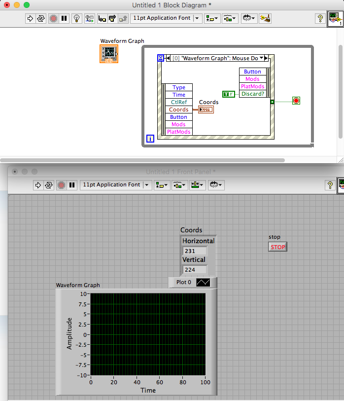

Works fine here, in LV 2009 (my latest version of LV for OS X 10.11.1).
It pops up the context help menu unless you DISCARD it.
It reports the coordinates as expected.
