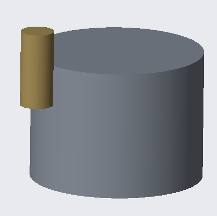

I am trying to make something like a CAM simulator , I started with a fixed object (cylinder) and a cutter (also cylinder) and i am trying to make the cutter to rotate around the axis of the cylinder and tangent to the top surface of the cylinder.
I attached the VI plus a video for what happened with me.

Your description of the cutter orientation doesn't quite make sense to me.  Is this what you mean?
The cutter rotation axis is perpendecular on cylinder rotation axis
like this
Message 5 of 12
(5,829 Views)
@hosa200 wrote:
like this
Ok, that is the way I interpreted your description but it didn't make sense from a machining point of view (coming from a non-machinist).  Smiley Very Happy
Your x values remain the same in the second Matlab script but I think it should be your z values remaining constant.  I can't open your VI to make sure.

Right.  And I am using 2012.  I can only see your picture and from there, I can't see which axis is x, y, or z.  Obviously, based on the video, you are changing the wrong values, so I am assuming that X is parallel to the top of the cylinder and should remain constant.

Sorry, I don't have a license of Mathscript to execute.  So assuming that your code for drawing the cylinder around the axis is correct (only the wrong axis was chosen), this is what I had in mind for the second MathScript node:
mXcut2=mXcut*sin((c*pi)/180);
mYcut2=mYcut*cos((c*pi)/180);
mZcut2 = mZcut;
