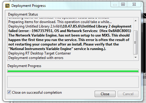

When we run, we get the following erros:

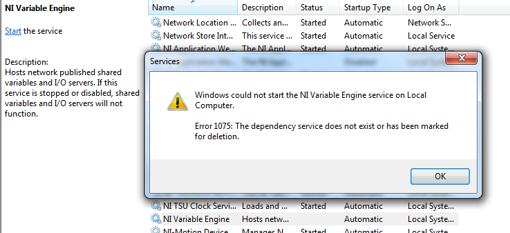

based on reading the forum, we tried to reset the MAX database to get the "NI Variable engine" because the windows services shows the ni variable engine is not running....  we tried this and it did not work...

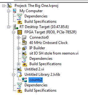

also here is our project structure...

Are you sure you're trying to use network published shared variables to communicate between the FPGA and the RT target?  Could you explain that a bit more or provide code screenshots (or actual code)?  Typically, there are two ways to communicate with an FPGA VI: read/write controls, and a DMA FIFO (the thrid, less common way, is User-Defined I/O Variables).  These methods are abstracted when using VeriStand because the XML you import (the *.fpgaconfig file) tells VeriStand how to interact with the bitfile via these methods.  If you are using the Model Interface toolkit, you are using LabVIEW (not VeriStand), so you will need to get the encoder values from the FPGA via read/write controls or a DMA FIFO.  This is accomplished on the RT side by using the FPGA interface functions palette:
FPGA Interface VIs and Functions
https://www.ni.com/docs/en-US/bundle/lvfpga-api-ref/page/menus/categories/fpga/dir-mnu.html
Transferring Data between the FPGA and Host (FPGA Module)
https://www.ni.com/docs/en-US/bundle/labview-fpga-module/page/transferring-data-between-the-fpga-and...
The RT code can read and write to network published shared variables, but the FPGA cannot access them.
