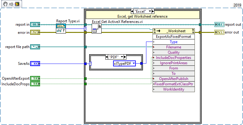

Good try so far, but the wrong ActiveX class and method.  The one you actually want is the "ExportAsFixedFormat" method from the Excel._Worksheet class.  (Think of it this way - you can't save a multi-sheet workbook into a PDF, but you can render a print-like representation of a single worksheet.)
Below is a handy (well, it's been handy for me) utility I created that isn't part of the Report Generation Toolkit, but I think would make a fine addition to it... hence the "stolen" icon background.  Since your example isn't using the RGT, just grab the ActiveX method call and the "Type" ring.  Note that there's a similar, though incompatible, method for Word automation in there, should you ever need that.
Hope this helps,
Dave

Thanks very much for your help.
I modified your VI a little bit and it is working perfectly.
Attached is the zip file that contains the full solution.
