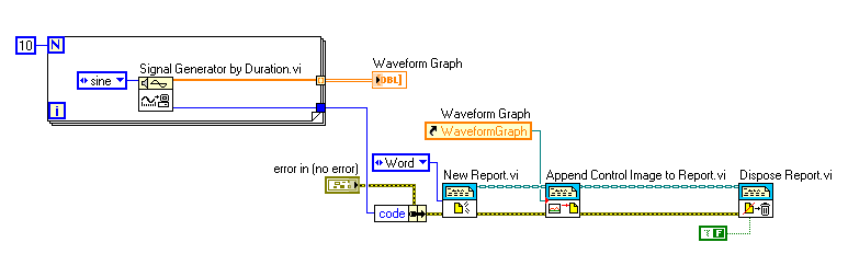

i use report generation for make this graph that's word insert graph.vi.
so can you tell me how to give name to x and  y axis?
tanx
Message 22 of 23
(993 Views)
Hi marp84,
If your ultimate goal is to insert the graph from the VI you posted on the first page of this thread, then you may want to look into using the Append Control Image to Report VI instead of the Word Insert Graph VI. The Append Control Image to Report VI will take the image of the actual graph on the front panel (with x and y axis labels) and insert it into your report. Here is an example of how it can be used:
