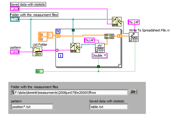

Sorry, I no longer have LabVIEW 7.1, but you could try the following:

Hi pascal07,
did you try it with the functions altenbach mentioned? If you create exaclty what altenbachs picture show, then it should work for you.

Thank you all for your help.
Yes the figure altenbach post is working correctly.
