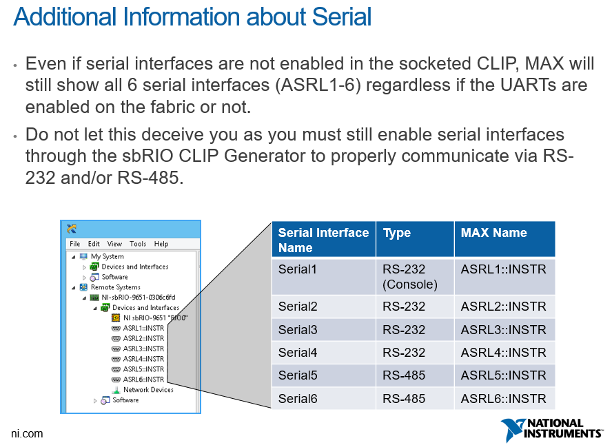

@tannerite wrote:
This presentation covers what a CLIP is, how to navigate through the sbRIO CLIP Generator, and how to import a socketed CLIP into your LabVIEW Project.

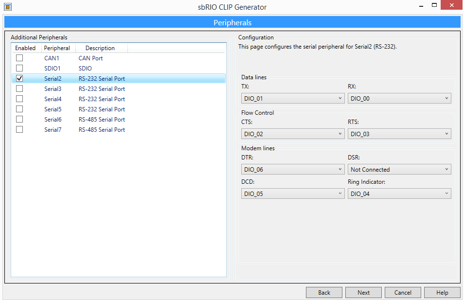

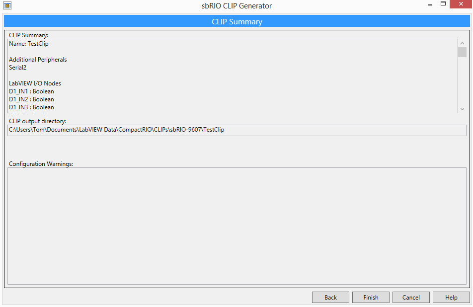

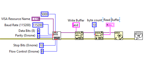

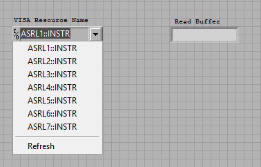

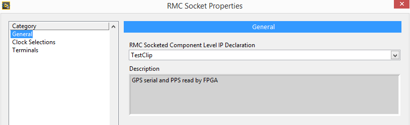

I have a very related problem with upper slide in my project, my hardware is NI sbRIO9607. I want to use the RS232 serial interface provided by Labview Clip Generator and I have also done all the necessary assignments written. But I could not find any way to access to the created port (serial nor parallel created by Clip Generator), with VISA or MAX. All DIO pins are working correctly without using in a Clip Generator serial port. However, only the ASRLx::INSTR ports could be accessed via MAX or VISA. According to the quote from publication which I put to the beginning, I understand that ASRLx::INSTR ports are the corresponding Serial Ports. However there is no data communication sensed while I am testing the pins by this assignment (i.e. I considered Serial2 is ASRL2::INSTR , and all of the other ASRLx::INSTR ports are also tested whether one of them might be the Serial2 port or not). I put screenshots below.
How could I access this Clip Generator ports, could you please help me?
