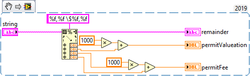

I made a cluster of each of the elements of the string and then parse the string to load the elements into the cluster. I am having trouble with the dollar values.
This only works if the values have one comma. I need a general solution for 0, 1, or 2 commas.

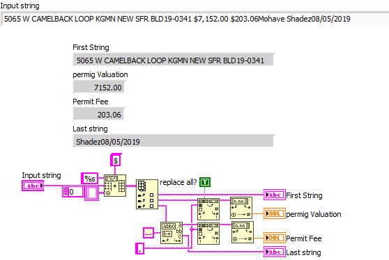

Not sure what we can assume about the structure of the input string, but here's a quick attempt.
"Assuming the $ character occurs exactly twice and always before a number, etc.)
I am sure it can be optimized further. You talk about cluster, but I don't see a cluster.
(487 Views)
Thanks for the fast reply. I took the easy way out and removed the commas. That made it simple.
(481 Views)
Yes, my code will remove all commas for the two numbers following the dollar characters.

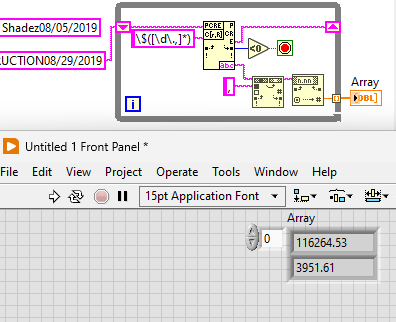

I immediately jumped to using a regular expression:
Jim
(416 Views)
My regex matches 0, 1, 2 or more commas OR decimal points!  That makes it not "work", but you've got other problems if the data has more than one decimal point.
