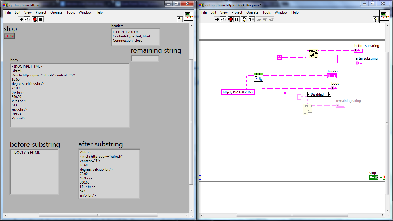

scan from string
how do i extract the individual values and get them to display on waveform chart or thermometer?
i have no idea on how to format strings as there aren't many examples given. can anyone help me?

Hi Gekides,

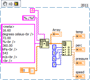

you may try this:
That's just one possibility, there are multiple others...
Next time you should attach a VI with some data instead of those pictures. So we don't need to retype all the text in your receive buffer display...

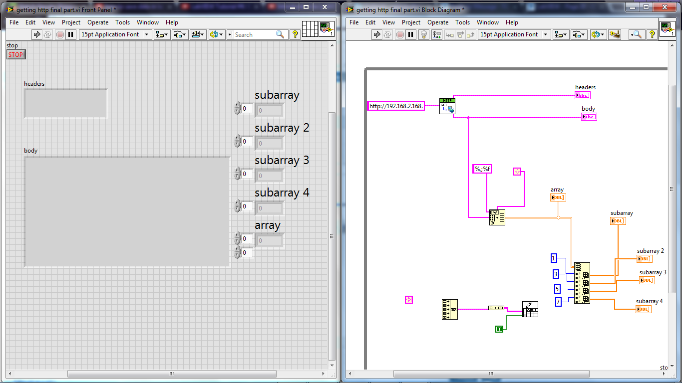

Thank you very much!!! may i ask how do i actually save those reading into microsoft excel? getting from http part 2(saving).png

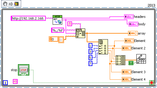

Hi Gekides,
try this:
You need to provide a filepath to avoid the file dialog pooping up in each iteration…
- Why do you use the format string "%,;"  when your numbers use the point as decimal separator?
- Why didn't you use the array constant input for SpreadsheetStringIntoArray as I have shown before?
- Why does your IP address has a point at the end?
- Why don't you use the CleanUp button?

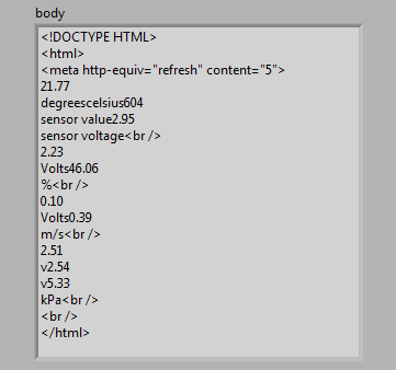

new body.pngHi this is my new program and somehow i can't seems to get the value out again. can you help me with it?
