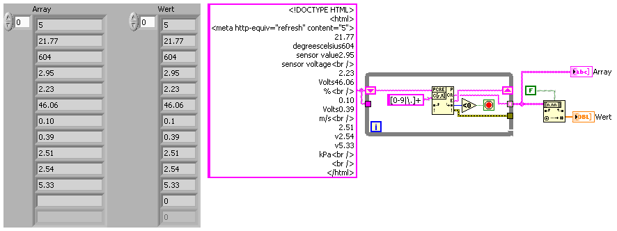

Hi Gekides,
you really should talk to the guy who created that HTML server - or beat him…

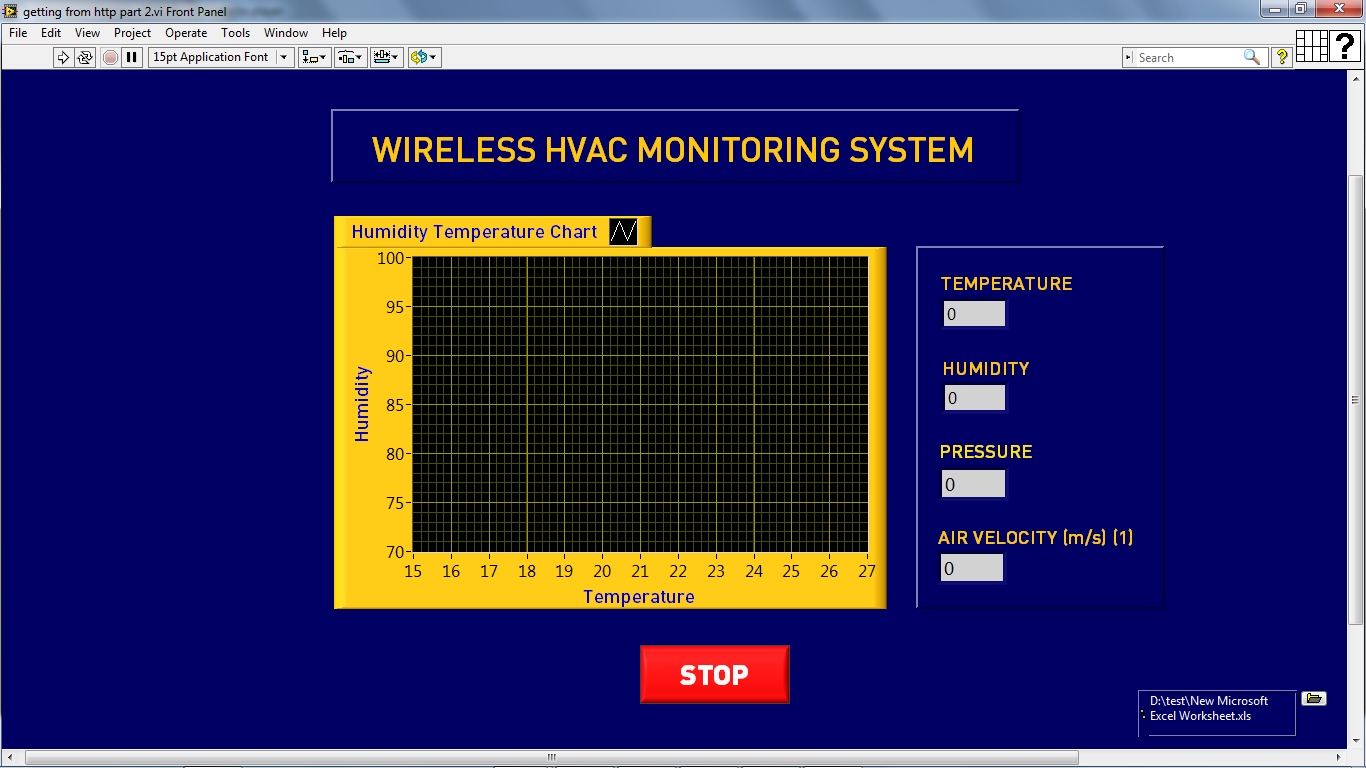

thanks. but the values that i will need are 21.77 degree celcius, 46.06%, 0.10m/s and 2.51kPa. is there anyway to extract only those reading because i will need them to be displayed on a numeric indicator?
something like this
Message 15 of 23
(2,462 Views)
You have an array, so just use index array to get out the indices that you are interested in.  Then convert them to numbers and send them to their respective indicators.

Hi Gekides,
my solution will give you an array of values and all you need to use is IndexArray to pick your needed values…
