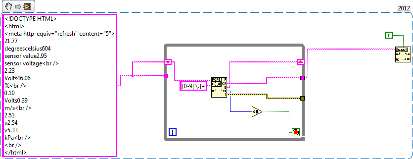

i can't replicate your VI. i don't understand the square box in between the shift register and error out. i also don't understand how to get the formula [0-9|\.]+ too.
i am actually new to labview so there are many things i am not quite sure. can i have a snippet of that solution?

Hi Gekides,
that's MatchRegularExpression and a string constant containing a RegEx

found it but i still can't make it look exactly the same as yours. mine look something like this
can i use this method to break the values?

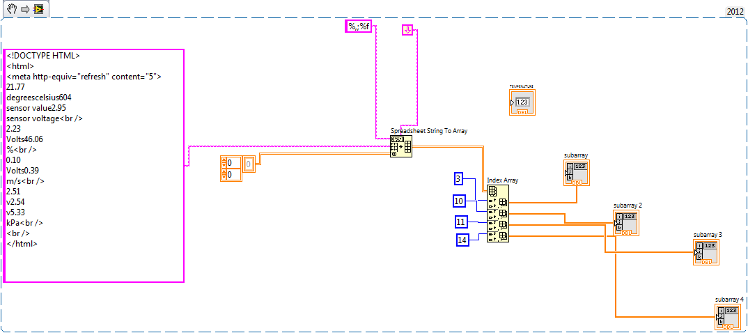

21.77 degree celcius, 46.06%, 0.10m/s and 2.51kPa
if this method also works, what number should i put in to get the values on top?
