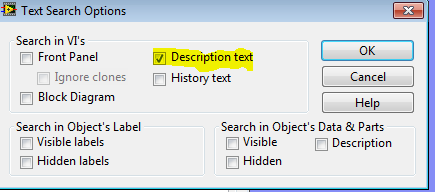

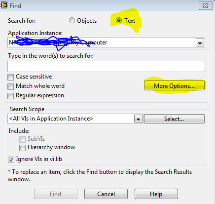

From any FP or BD hit Ctrl+F
Select "More Options"
