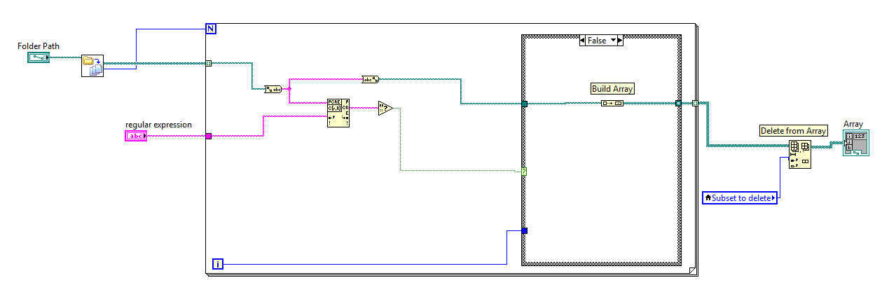

Here screenshots on how to implement the first option using build array:
And the true case:
Norbert
PS: Note that this procedure is only recommended for "small numbers of files to search for". Build array can blow your memory, so if dealing with lots of files, you should follow option 2.....

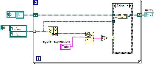

Hi my friend, How are you ?
This is what I did till now,
I'm waiting for your remarks and observations.

Your code will most likely not work as you expect... did you try it?
Norbert

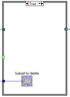

Yes I did, It works good, the only problem that I still have, in the result I got some empty boxes in my array !
I tried in vain the function "Delete from array" !
have you any proposition to do that ?
Message 14 of 18
(1,006 Views)
You only delete a single entry from the array.
The reason is that the "subset to delete" will only store one value. Reading the variable will create a copy of "subset to delete" sometime during code execution. So you will not know when the variable is read and what the value will be. This is called "race condition".
You have to create an array of indizes to delete.
Norbert
