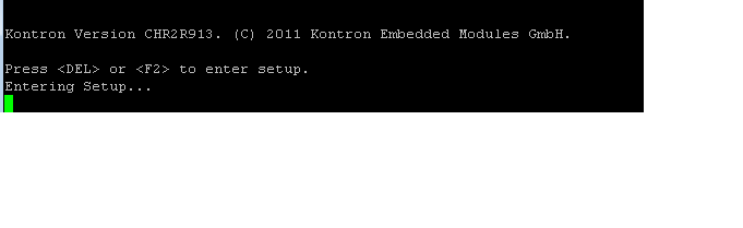

send F2 key using serial com connection
Hi ,
To enter to Bios in need press "F2" key .
how to enter F2 key using serial ?
is it string  ?

I don't think you can.  An F2 key is not a byte or character you can send over the serial port.  It is a special key that only the PC that is connected to that keyboard through a keyboard interface will know what to do with it.
You could try sending the byte 127 (decimal) which according to the ASCII table in the following link is the DEL byte:
https://www.asciitable.com/index/asciifull.gif&imgrefurl=https://www.asciitable.com/&h=488&w=715&tbn...
What is this device you are connected to giving you this screen?  I have doubts that even that would work.  You are trying to enter the BIOS which is happening at the lowest levels of this PC.  I don't think serial drivers would even be loaded yet.  At the BIOS stage, just enough drivers have been loaded to handle the screen and the keyboard connected to it.

I am trying to enter to Bios of  Linux machine (CPU).
By SERIAL from my computer (7WIN)

Accepted by topic author hod77
The solution is:
Change in the Putty settings to VT100.
Press the F2 key and then I got "OQ"
It should be added at the beginning 27 or 0x1B (ESC)
