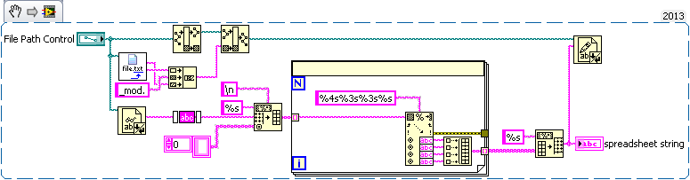

Take a look at this
Randall Pursley
Message 3 of 10
(3,607 Views)

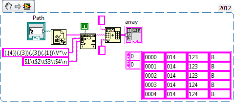

Hi Randall,
just slightly Rube-Goldberg… 😄
No need to build lines and remove the EOL, to finally put all lines with their EOL chars in a spreadsheet string. Just do it with one function… (Your version might be more memory efficient with bigger string arrays.)

Simple to use a loop to create dynamic search and replace strings based on an array of widths as well.

Hi Darin,
I really should learn RegEx someday… 😄

hi, thanks for the quick response. can i have the vi since i am new to labview and not familiar with the palettes. thanks

it's a SNIPPET!

hi,
i have created the vi as per in the image but i still cannot read the value.refer to the attachment. Can anyone advise me on that? thanks
Message 9 of 10
(3,489 Views)
Accepted by varsha88
Hi varsha,
- you forgot to enable the "Regular Expression" mode in the right-click menu of the parse function (did you notice the small star in the symbol?)
- you wired the TRUE constant to the  wrong input
- the second string constant should be set to \-code display mode (well, I guess there's a LabVIEW idea to show the display mode of string constants by default…)
