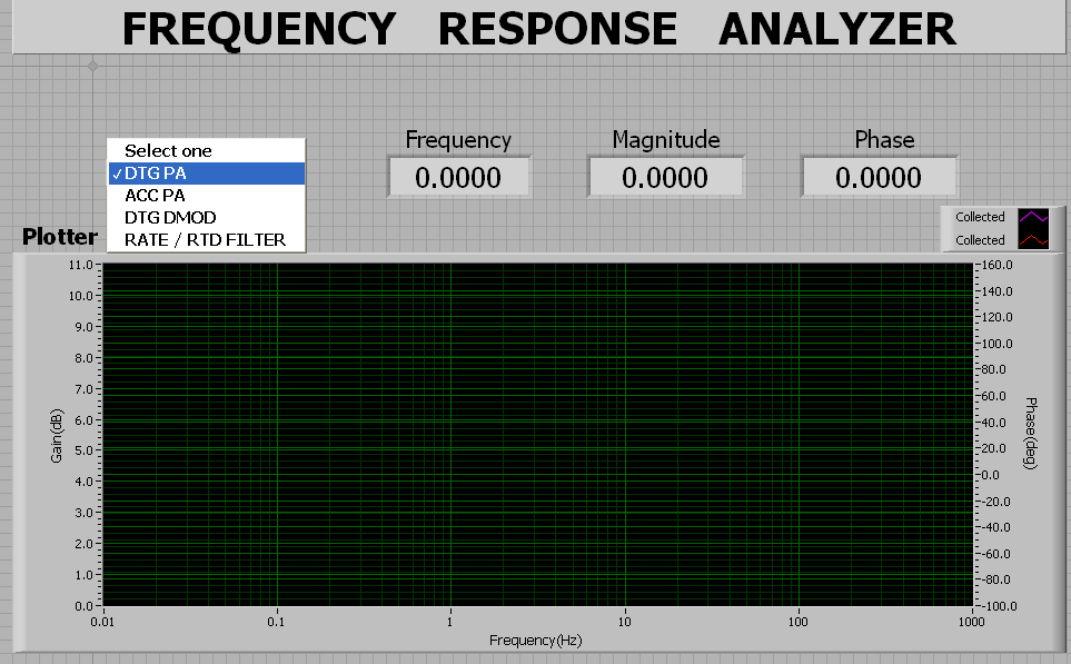

I finished my project with FRA. Now In my lab all are using this one (others also asking!!!!!). I had Display of Freq,
magnitude, and Phase And also  I made a plotter of 3 axis(X,Y and a secondary axis). It can be used as online and offline
Online means at time of sweeping this will save the data in "*.txt "format and also will plot
Offline means from the saved data it will plot automatically.

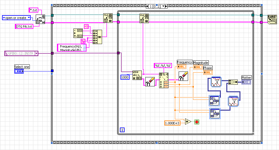

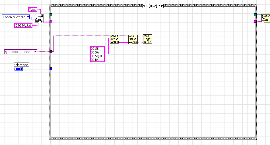

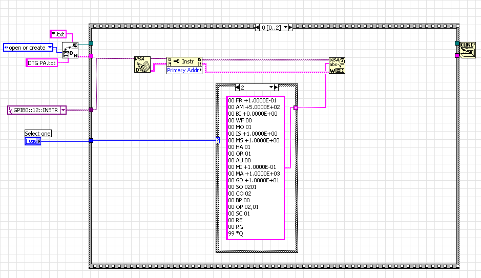

 Hello
I made for my purpose only. You can change the codes(from the manual) as per your project. or else you can write a in
format string palette command format is" %.;FR\s%f\n".same format can use for others like amplitude is" %.;AM\s%f\n"
etc etc
