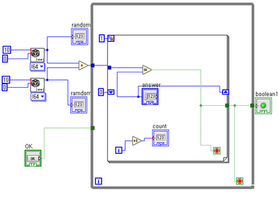

i made it up to here
but the count isn't increase and when i apply the wrong answer, the boolean is always green light( i set the boolean on: green off: red)
i can't use the OK button, it isn't work

You are trying to repeatedly poll the OK button, but the value never changes. The State of the OK button is only tested at the start of the program. Every time the while loop runs, it will see the same state of the button. You have to move it inside the while loop.
The For loop is not suitable for your problem, because there is no limit on how many times the button can be pressed.
You will want to repeatedly
  • Read the current state of the button
  • If the button is pressed, read the user's guess and increase the number of guesses
  • If the guess is correct: Display the number of guesses, Switch the LED and exit the program
  • If the guess is not correct: Return to the top

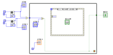

as you say, i use the event structure. so now i can repeat the progress.
really thank you!!!
but there are still not correct.
when i write the correct answer, the program is not stop immediately.
i have to push the button twice
and tell me how can i set the boolean reset when i start the program
(3,394 Views)
I can't read your text to know exactly what each control is.
But I am pretty sure your numeric control that would be the guess belongs in the event case.  Because right now it is read early in the iteration of the loop, then execution pauses at the event structure.  If the user changes the value, it won't be read until the next iteration after the user hits the boolean button.  Then the new value gets read, a true is sent to the stop terminal, and it waits at the event structure again waiting for button press.
Turn on highlight execution and watch the data flow so you'll understand!
