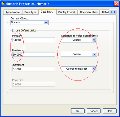

Ravens option is better because you can also add a minimum value.
The last option you can do is to enter the numeric control option and to this:
Though I don't know how reliable this is.. It is obviously the most space saving.
