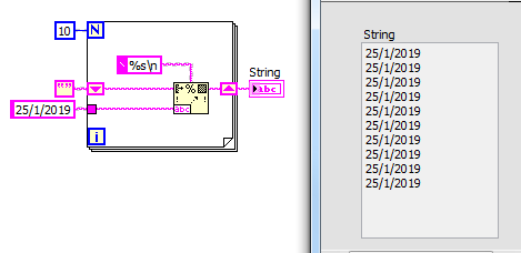

Hi everyone this is what i would like to achieve for my string indicator:
25/1/2019
25/1/2019
25/1/2019
instead of all the strings being all together(see picture attached)
I have refered and tried https://forums.ni.com/t5/LabVIEW/insert-space-in-string/td-p/2536200 this post but i could not get it.
I also refered tohttp://zone.ni.com/reference/en-XX/help/371361L-01/glang/match_regular_expression/ and changed the "$1" to "\n" for new line but to no avail.. Pls help

Hi GerdW is this what you meant? I still cannot get :
25/1/2019
25/1/2019
(5,658 Views)

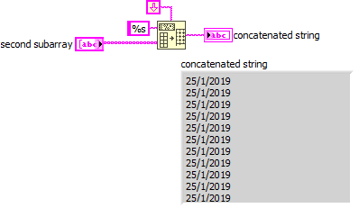

OK, thanks for posting code and data. The code is such a mess that it is difficult to tell what you actually want. Fortunately, the file contains nicely comma delimited fields. Since nothing ever changes after the first iteration, you can probably delete the while loop, right?
If you just want the dates, take the "second subarray" and use "array to spreadsheet string" with  %s as format, and line feed as delimiter.
