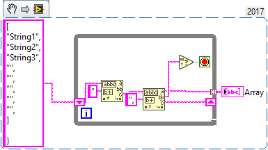

This would get you started:
Tim
GHSP

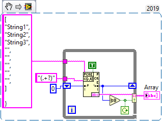

You can use a regular expression to solve a problem like this. Assuming you're only interested in strings between double quotes the following code will extract all the non-empty strings (you can add as many strings in double quotes as you want) . If you want to get the empty strings also just replace the "+" by a "*" in the regular expression.
Ben64
Message 6 of 8
(5,052 Views)

Hi Ben,
it was just what I needed thanks !!!
you don't know how much time I've lost for it
kudos comiiing
