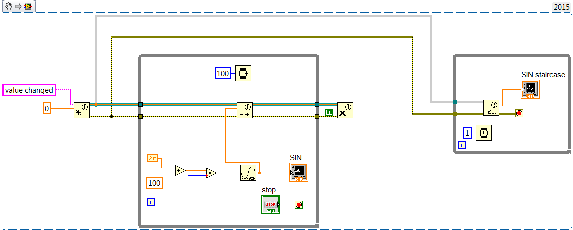

In this VI I'm trying to generate staircase sinus.
There are 2 loops - in 1st sin is generated, in 2nd it is captured with sampling rate 100 times superior than it's generated.
But 2 shapes look similar.
Where is  a problem.

I think by default, the notifier will wait indefinitely for a new notification - so your second loop is running at the same rate as the one generating the data.
Use 'get notifier status' to get the current value without waiting for a new notification.

Thanks !
