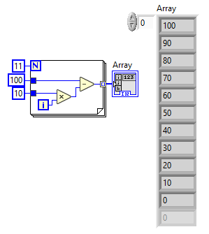

it is super easy when you are familiar with all of labviews peculiarities -
for anyone interested I did this

Are you sure you want the For loop to run 100 times?
Message 8 of 9

@charliejeynes wrote:
HI i'm having a brain freeze can someone tell me how to fill an array in a for loop so it has 100, 90, 80,         70 etc - this is so simple but i'm having difficulty initialising the array and building it with shift register etc
The "etc." poorly defines the problem. Do you want stop at zero? At 60? At -1000000??? What do you want the final array output to be?
And yes, I would do something similar to what Ben suggested.
