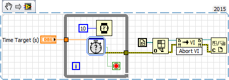

Try this:
=== Engineer Ambiguously ===
(4,174 Views)

Then don't make it a sub-vi.
I would just put something like this right on the top level VI block diagram and have it run independently of the main program.
(4,151 Views)
