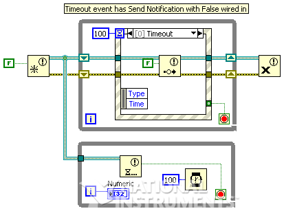

You could use a Notifier.  In the following example, I used an event structure to capture the stop button event.  When the stop button is pressed, set the notifier True.  In the Timeout case, set the notifier to False.  The timeout is needed so that the 2nd loop doesn't sit there waiting for a notifier.  It will execute at the same speed as the timeout value.
21800i4AD7160C23530C4E  This is a simplified producer-consumer architecture.
- tbob
Inventor of the WORM Global

@Drewski wrote:
This example uses "latch on release" mechanical latching option.
Look again.  The stop button uses Switched When Released.  It even says so on the front panel.  The disadvantage of this is that you have to set the stop button back to false either at the end of the program or at the beginning.
- tbob
