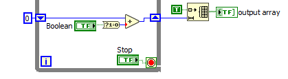

Thanks for answer
what i  want is like this:
just when i press boolean button, store a record in array. but it is not working like that and  even when i dont press botton, array continue recording.

@amkamyab wrote:
please see the picture.
Your problem is in the diagram, not the front panel, so why would you show a picture of the front panel??? We cannot troubleshoot that. We need to find the cause, not the effect!
Here's one simple possibility:
Message 4 of 15
(5,319 Views)
... and if you don't need the array during the loop, built it at a conditional output tunnel.
Of course it seems completely pointless to create a potentially large array where all elements are the same. How redundant! That array can be described by a single integer! Maybe you could just keep count and create that array at the end in one swoop!

thank you @
can you show me what must be in false case?
Message 6 of 15
(5,308 Views)
Can you take a wild guess???
(In the false case, nothing should happen to the array, so it would be just wired across unchanged, right? You really need to start with some basic tutorials before continuing!))
