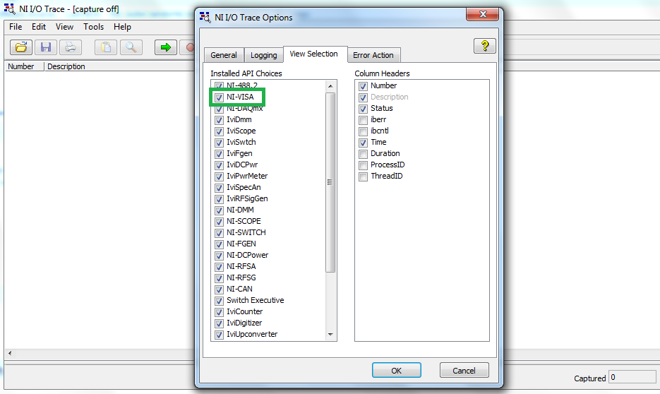

do you have something to check if the data is actually written to the buffer correctly?
If the DLL uses NI VISA, you can use "NI I/O Trace" to verify this. You can start this tool (if installed) using LV >> Tools >> Instrumentation.
hope this helps,
Norbert
