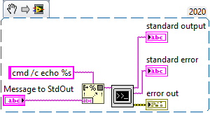

I don't know if this solves it, but it do send a message to StdOut.
/Y

LabVIEW is a graphical application which displays data in its window, it is not like an old school DOS program which outputs to the command prompt.  That said, there seem to be some ways that appear to be a hack that can put data to a standard output DOS prompt.  But you'll have to google for that.  When I did, I had some hits, but I don't have the time or desire to test them out.
Before you do down this road too far, it is time to ask what are you REALLY trying to do?  Funneling data out of a DOS prompt is so archaic, I'm sure there are much more modern methods to accomplish what your actual goal is.

If the point of the thread is to call a python script, there's a Call Python node. 🙂
