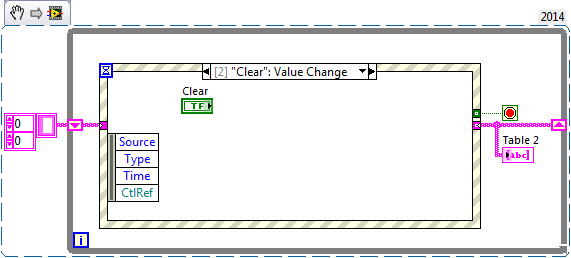

Use one more event to clear the data.
Drag and drop this snippet on LabVIEW block digagram window to get the code.
Munna

strange things happens now 🙂 here is what i did
Message 17 of 38
(2,822 Views)
Hi drek,
what is "strange"? What happens at all?
Why don't you attach the VI? Why do you attach just images?
What is displayed in the table?
Message 18 of 38
(2,817 Views)
the data jumps each time to a different place, i can clear the table with the button but still the previous data appears,
forgot to attach the vi 🙂 so here he is
Message 19 of 38
(2,796 Views)
1. You have multiple shift registers on top of each other.  That could make things interesting.
2. You do not need to have waits inside of your event cases.
3. Do you really want your loop to stop when you add an item to the table?  You probably want a stop button for stopping your loop.
4. Do not use switches for commands.  Use buttons (like the OK button).
