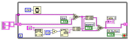

so before i began to change this was for me the best solution but the reset did not work

Hi drek,
solution without event structure:

i afraid of asking this 😞 all data keeps on coming without pushing the append button do i use the wrong switches ?
dont know the swtich you use (sry dont kill me) but many thanks in advantage for the patience

Ok, let's take a step back.  Where is your data coming from?

data comes from an rs232 1 number and with this number there is a formula for thats why i use 10 and 15 as example
all of that is working as you can sse in my last vi everyting is working except that when i have to delete the data in
the table the still exists, and whats working in my last vi you can see the append button works.

I think you want you clear code to happen after the append code.

well the data is coming from a measurement by append i put the 2 numbers in the table (same row)
by the next append i put the next 2 numbers in the table en so on.
but if there is something wrong with the measurement i should be able to empty the table
and start again from the 1st row or better but more difficult i guess i should be able to
delete the wrong numbers at a row.
But always when i do a new measurement i should be able to clear or reset the table.
Afterwards i after should be able to write the table to a spreadsheet.
How you will check the measurement is wrong or not?
If you know the criteria, use GerdW's solution.
You got some nice ideas (solutions) for your query.Please use those and solve your issue.\

to see if a measurement is correct i can that on the display of the machine, looks not so simple to make
a table in labview

Hi drek,
looks not so simple to make a table in labview
Creating a table and filling it with data is really easy with LabVIEW - as you can see in all the suggested solutions…
