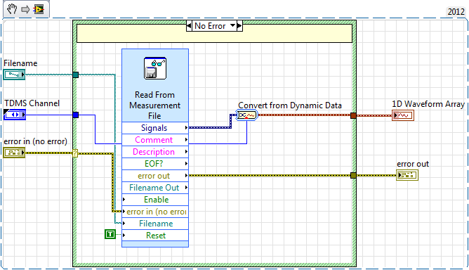

I sample ten AI channels using DAQmx and write these to a tdms file using 'DAQmx Configure Logging (TDMS).vi' with 'logging mode' set to 'Log'.
Each channel has 1.8 seconds of data that has been sampled at 1MHz.
I later analysis each channel data (one at a time) but would like to optimize my code for memory efficiency since I sometimes come against the dreaded "Out of memory" error.
Ideally I would like to be able to specify only the channel that I want to read, however using the 'DAQmx Configure Logging (TDMS).vi' does not allow me specify channel names.
I can use the express vi to read but all the data comes out and I need to select which channel to extract from the dynamic data. What I don't know if is the dynamic data already memory efficient or is there another method I can use?
If I use the 'tdms open file' followed by 'tdms read' ans use 'index array' I can also get a single channel but reading all the channels out puts all the data into memory at once when i only want to read one channel.

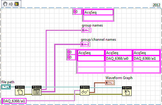

Tried again following your suggestion and indeed I can now see the channel names which I can now use to specify the channel to read.
It gets the channel names automatically from the Task input to the 'configure tdms for logging' vi, which in turn comes for how you specify the AI physical channels to acquire.
Easy when you know how!
