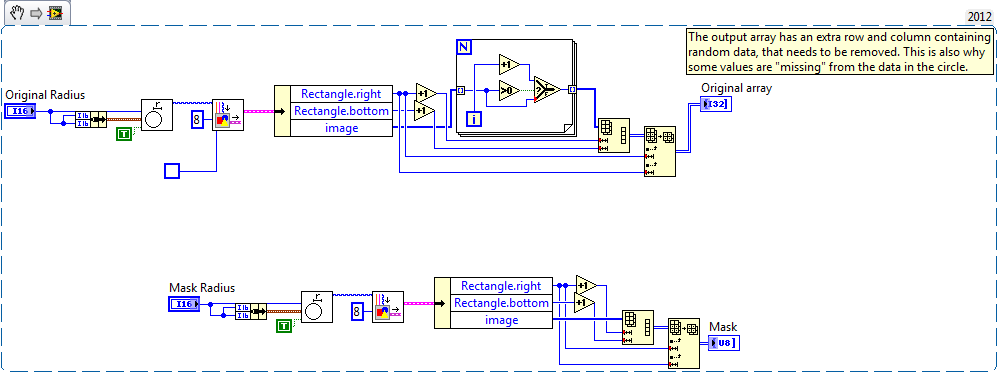

I think I understand now. I don't have a solution, but sounds like a fun problem to consider over the holidays. I think going to IMAQ is overly complicated, but I'm not that familiar with the IMAQ functions. Here's the beginnings of an approach that uses the Picture palette functions to generate a circular array of data (in this case, both an original and a smaller mask, using the same code). I'll post back if I happen to make any progress on repeating the smaller array inside the larger one.

Here's the snippet I meant to attach. Oddly it appears I succesfully uploaded it, but it didn't get attached to the previous post.
