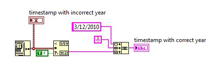

A solution to this issue would be to adjust for the year programmatically by doing something like this:
