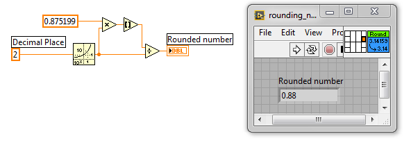

multply by 100, round, divde by 100. (Using floating point math you will introduce rounding errors in the last step.)

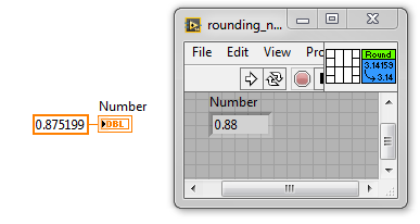

Do you want to round, or truncate? In order to round in LabVIEW, you need to multiply by a factor of 10 to the number of decimal places you want, round to the integer value, and then divide by the factor again.
If you're just trying to display the number to certain decimal places, just format the indicator to show to 2 digits of precision. (Right-click > Display Format)

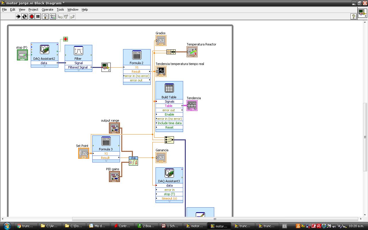

hey, thanks evebody to take it time for answer, let me explain a part of my project:
the first DAQ assistant obtain a voltage that is proportional of the current temperature (i am working with a thermocouple type K) but that value has noise i am trying "clean" the signal with the filter, after that i need obtain a value only with two digits 0.00 , because i need a signal very stable, maybe you have any idea to process my signal.

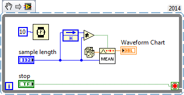

Cutting off your extra decimal places won't make your signal more stable. That's not how it works, you're just cutting off some of your info. You could implement a running average of your data so that the display doesn't jump around.
Check out this Mean PtByPt looping with a random number between 0 and 1. Play around with it a little bit. If you adjust the sample length, the higher it gets, the more stable the graph becomes (centerred around 0.5).

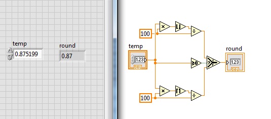

indeed if you want to show 0.875199 as 0.87 you should not use  nearest round
you have to use Round Toward -Infinity Function not nearest
also if you have minus temperature and want to round it toward 0
for example - 0.875199 to - 0.87 you should use some thing like this code temp.jpg
