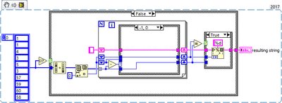

I made this ages ago.
(4,146 Views)

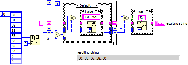

@tshurtz wrote:
Anyone know where I might find this magic vi? I can write my own but if its already available all the better.
I am sure this has been solved before here in the forum. But should be trivial to implements if we can make certain assumptions:
  • Is the array guaranteed to be sorted?
  • Are there no duplicate elements?
Assuming the input is clean, this might work for you. There are many other ways.
(4,072 Views)

As I said, it really depends how clean the input array is and additional code might be needed.
One request thought. Please give a VI a new name when attaching a new version. It can lead to serious confusions if a thread contains multiple different VIs, all with the same name.
At this point I would suggest to turn it into a malleable VI (vim), correctly accepting any integer datatype. (only available in recent versions, but alone worth the upgrade!)
