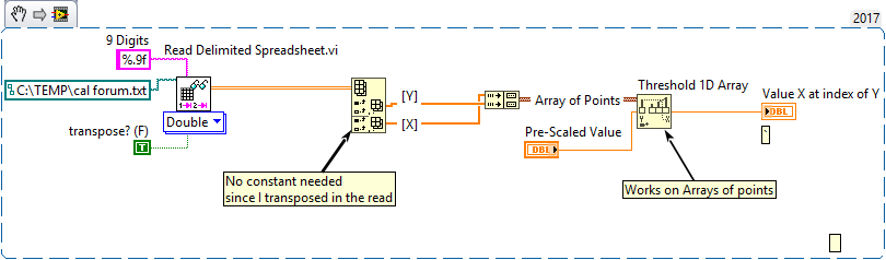

You have attached a "Text" file a "LVM" is different.
In this case your columns are tab delimited with 9 digits of precision.
Read from Delimited file with a format specifier of %.9f and Transpose? = True
Index array to output t rows (the file columns)
Index and Bundle to provide an array of clusters of two doubles, or Points <x,y>
Threshold array to return the value of y at the index of x

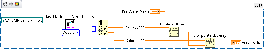

Rather than a lookup table, you could also use Threshold and Interpolate to find the value.

Close but, you missed a very nice feature of Threshold 1D Array
Capture.png.

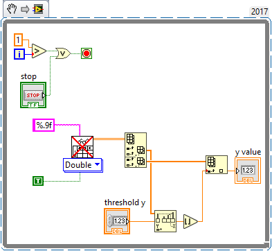

hi shane, i tried, but it has an error, when i try to connect the resulting spreadsheet to the "search 1d array", i'm attaching the vi,any ideas?

Thanks!
i did as you told me, but it doesn't return the number i need, for example, y tried with -117.3907001, and it should have return the number next to it (-5.98789879).
instead, it gave me a number that is close to the folowing number ofthe same column (-117.3519983)

two mistakes.
1) your fault. you cant transpose the array and wire 0 to index of column. you get a two by two array that way.
2) maybe a mistake in requirement. if you need the value of Y closest to X rather than the value of Y that would be at the fractional index of X you need to rfound down and index rather than interpolate
Message 9 of 13
(3,891 Views)
it worked!! thanks so much!!
