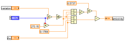

Well, I'm not sure what you mean by a "bit heavy". The equivalen G-code would look like this:
Don't know if that's heavier than a formula node. I can say one thing: If you're going to be performing the calculation a lot then the G-code will most likely be faster since you don't have the overhead of the formula node.

Ok! Then I will have to change my formula nodes for G-code, because the faster it is performed the better!
