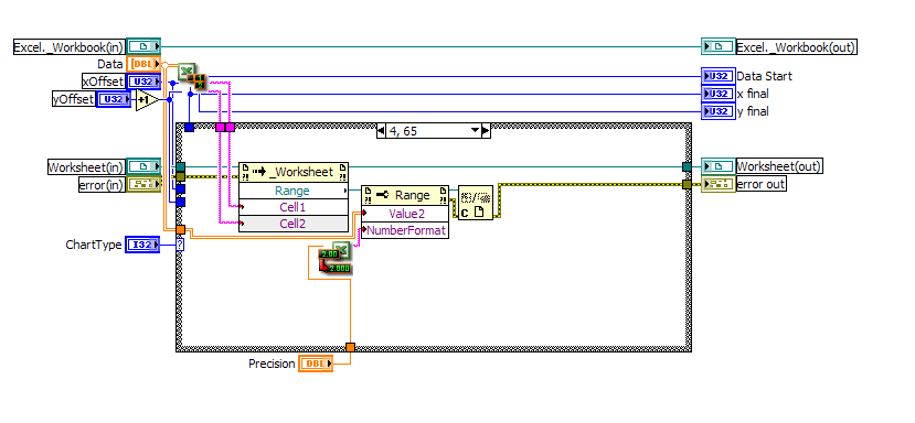

hi
Here i have attached the screen shot of the code for Read and write in activeX Spreadsheet.In that, Read is working. Wite method is not working but it doesn't shows any error.see my attachment....
(5,829 Views)
Try giving the starting cell only on the range input i.e C3 not C3:D6
Tim
GHSP
(5,827 Views)
Like this
Tim
GHSP
