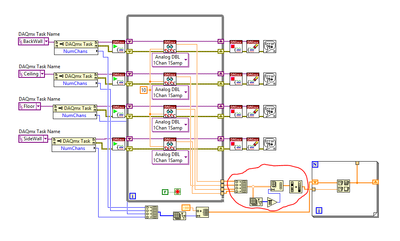

unnecessary redundancies in my code?
I have a sneaking suspicion that I may have some redundancies in my code, but I'm not really familiar enough with LV to pick them out.
In this portion of the VI I'm trying to read all the channels from the modules, keep the channels in order, sort out the max readings and send them to individual indicators.
Thanks for having a look.

I do see two major problems.
How long does a For Loop run if it runs Negative Infinity times?
Also, your tasks imply that each one has multiple channels, but in the For Loop, you are reading 1 channel 1 sample.  So you are only getting what I assume is the data from the first channel in each of the tasks.
I don't really see redundancies, and the stuff I listed above needs to be fixed first.  But I think you could do a max comparison on each channel within the acquisition loop rather than waiting until after it is done.
Example_VI_BD
Actually you can remove that inner For Loop.  Max and Min will work on arrays.  Just right click and make sure it is set for Compare Elements.

RavensFan has addressed the DAQ issues. There is also the issue of updating a ton of indicators. I would try my hardest to reduce the number of controls (with arrays, clusters, etc...) but based on a previous post I know that you want them all separate. One way to do it without too much overhead is to use the "control index". You first have to obtain the index for your controls, then you can just send in an array with the correct datatype to update the array of control indices. You will probably already have the indices in the correct order, but in case you don't, I have sorted them first so they are always in alpha numeric order.

I just wanted the for loop to run till I hit the stop button, +infinity filled the memory up in my computer in about 4 seconds which is why I used -inf.
I didn't notice they were set to read 1 channel, i'll set them to multi channel 1 sample.
I put max comparison outside the acquisition loop mainly because I want to data log once per minute all channels, but I don't want to log the max comparison just whatever the channel value is at the time of the log reading.

I'm a little confused what you mean by "controls" on your previous reply. I have a ton of indicators not controls,right? Or are you talking about the controls to change the BG colors for indicators on the front panel?

Oh yes, in this case you can interchange control with indicator. There is no such thing as an "indicator index", it is called a control index whether it is for controls or indicators.
But your code doesn't show a stop button.

@RavensFan
 Ravensfan,
Example_VI_BD
Does your example render this portion of code useless(red circle)?

It also renders the For Loop outside the while loop useless.
