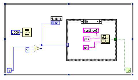

In the Vi attached I would like the user to be prompted with a question to continue increasing by 5 after 50 is reached. He can either choose yes or no and the program continues incrementing if yes is chosen.

@aeastet, I am using labvie 8.6 and so could not view your code
@elset191, I ran into the same challenge as the code you have provided. The prompt keeps coming up even after you click ok. After clicking ok, the prompt should close and the increment should continue.

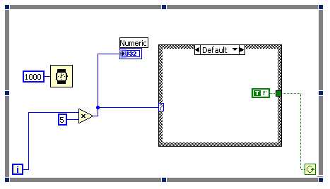

I'm poor and only have LabVIEW 7.1 so I can't see the magnificent structures these guys have made, but I'll have to assume it looked something like this:

Hey Billko,
That was brilliant.
Thanks a lot.
Oh.  I misunderstood your spec.  Simply replace the > with an= and it works how you would want.
