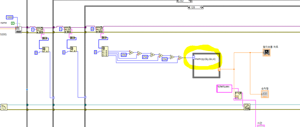

I want to use memcpy in formula nodes.
But there is error in my program.
Labview is not support memcpy?
or I mistake somethings?

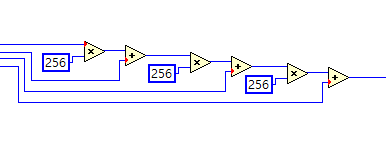

And, Labview program receive 4*8bit hex data
And convert to 32bit hex data
After that, I stuck how convert to float value.
In C language, I use memcpy.
How can i convert in labview?

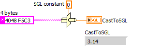

Typecast the 4 byte string to a SGL. (virtually no code needed. Reverse the string if you need little endian byte order or use unflatten from string instead)
See attached.
(In your original code, make sure the outputs are SGL, not DBL)

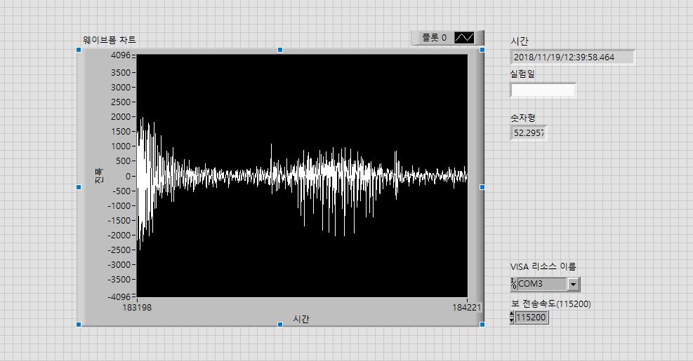

Thank you for your help.
Work very well my program캡처.PNG.
