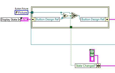

If you're changing the Display State cluster in a event case like you are doing for the Data Change case, you need to set the "State Changed?" boolean from the Action cluster to True so that LV applies the changes 🙂
Here is good template to apply when you need to store a control reference in a XControl state. This piece of code must be inserted before entering the Façade loop. Also, Data Change is not the best case for this kind of code, better would be Display State Change 🙂

Two questions:
  1. Why do you use the In Place Element Structure?
  2. And why should that code happen before entering the Façade Loop instead of in just one case?
(4,236 Views)
In place avoids making data copies during the execution - http://www.ni.com/white-paper/6211/en/
And because the façade VI does not execute continuously, you don't really know which events will be fired according to your interactions with the XControl. Adding the code before the while loop or inside the timeout case (which I don't prefer because this case is not meant for this) is the best way to make sure it's executed every time Façade executes.
Hope this helps 🙂
