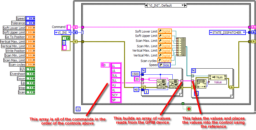

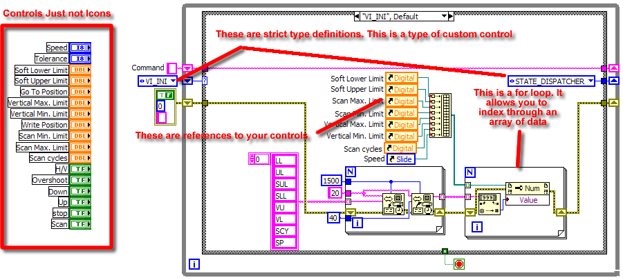

First of all, thank you aeastet.
I/We have checked your program, but since we are both not so great at labview yet, it is quite hard to understand this program you have written me.
Could you give us a little explanation of what you have been writing? For example, we do get the big picture, with the case to initialize and after that dispatcher + sending. The problem is a few blocks we havent really seen yet. All these numerics and stuff outside the while loop, what are they exactly, or are they just a different way of viewing them? The stuff with the digital at at INI phase, The block in the lower right corner of the INI phase, and the digital block in the dispatcher phase we didn't really understand.
Message 7 of 11
(4,266 Views)
The problem is a few blocks we havent really seen yet. All these numerics and stuff outside the while loop, what are they exactly, or are they just a different way of viewing them? The stuff with the digital at INI phase, The block in the lower right corner of the INI phase.
The digital block in the dispatcher phase we didn't really understand.
I am not sure what you mean here can you circle it and send me a picture so that I can explain.
Tim
GHSP
Message 8 of 11
(4,259 Views)
