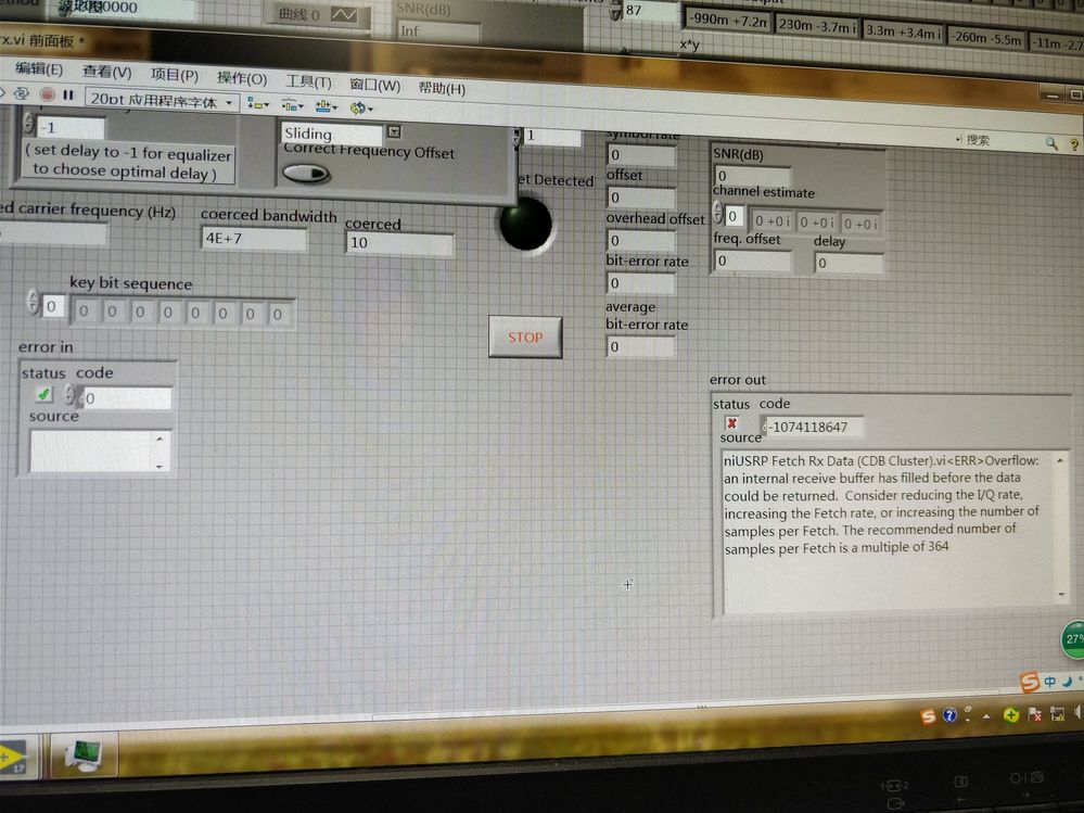

I have programmed a project and used in  usrp N210,the program can work sucessfully.But when I changed the device x310, it didn't work and have a problem in Fig1. When i transmitted data,the receiver part can not receive continuously but only once.Looking forward your reply. 咨询.jpg咨询.jpg

You're not reading the data fast enough. Is the system (pc) the same as the other project? It seems this system is just not processing the incoming data fast enough. So decrease the bandwidth, or upgrade the computer.
