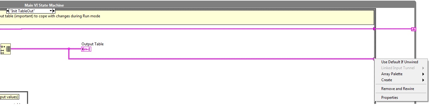

Hi GerdW,
by the way there is no option 'use shift register' for case structure

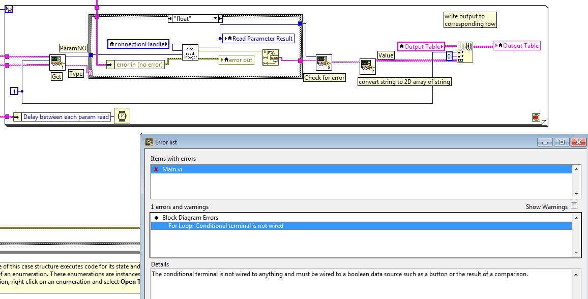

And the reason why I connect False to the conditional stop of for loop was because of:

Hi Hakam,
I never said "shift registers go with a case structure" - I told you "shift registers go with any loop"!
As this is a VERY basic LabVIEW thing: Did you take the free resources for LabVIEW beginners offered by NI on their website?
Wrong!
The reason for that FALSE constant is: you accidently enable the stop condition of the FOR loop! Disable that feature and you will not need an additional boolean constant!

@hbs_80 wrote:
Hi GerdW,
In that case you can use a Feedback node which (to a limited extent) can be thought of as a "Loopless SR".
Ben
