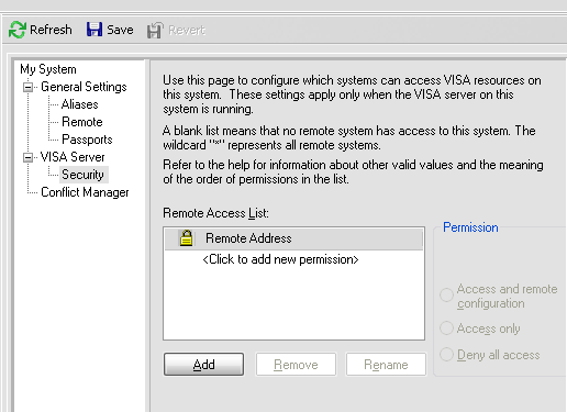

Hey Guanglei,
It sounds like you have not configured the access permissions for NI VISA Server. In MAX, go to Tools > NI VISA > VISA Options, then select Security under VISA Server. Add a new permission and don't forget to click Save:
 Valid network addresses include letters (a-z, A-Z), numbers (0-9), hyphens (-), underscores (_), and periods (.), but no spaces. IP addresses (xxx.xxx.xxx.xxx) or their equivalent DNS names (machine.domain.com) are also valid remote addresses. Other valid entries include "*" for all network addresses, "xxx.xxx.xxx.*" or "xxx.xxx.*" for subnets, and "*.com" or "*.somedomain.com" for domains.
Hope this helps!

Thanks a lot, this solves the problem... I forgot to click save in my own tryouts.
